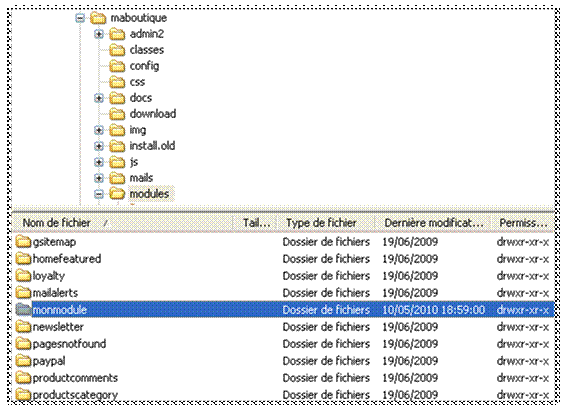

The module must be placed in the folder /modules in your PrestaShop store, as shown in the image below.
Transfer Module
